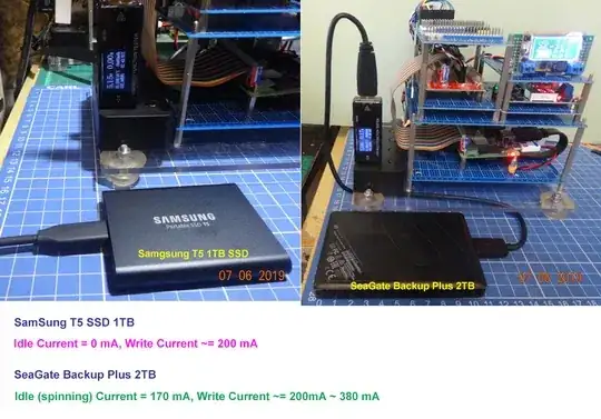

I measured the idle current and write current of a 1TB SSD, and a2TB HDD.
SSD's idle current is 0mA, and write current around 180mA
HDD's idle (spinning) current is 170mA, and write current 200mA ~ 380mA
My conclusion is that for hobbyist's python programming projects with casual use of SSD or HDD, there is no need to supply external power to the USB hub. If two SSDs are used for professional projects, it is better to supply external power to the USB hub.

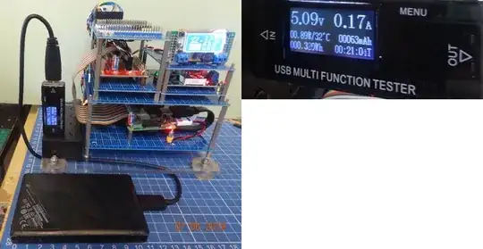

Well, it also depends on your SSD/HDD's power requirements. For reference, let me describe how I am using one 2.5", 5,400 rpm, 2TB SeaGate Backup Plus Model SRD00F1 HDD, as shown in the picture below.
usb hdd

I first tested the HDD using an USB hub without external power, on both Win10 PC and Rpi3B+. I found the following current measurements.
  1. Idle (spinning) current ~= 170mA
  2. Startup and working current ~= 200mA ~ 380mA
