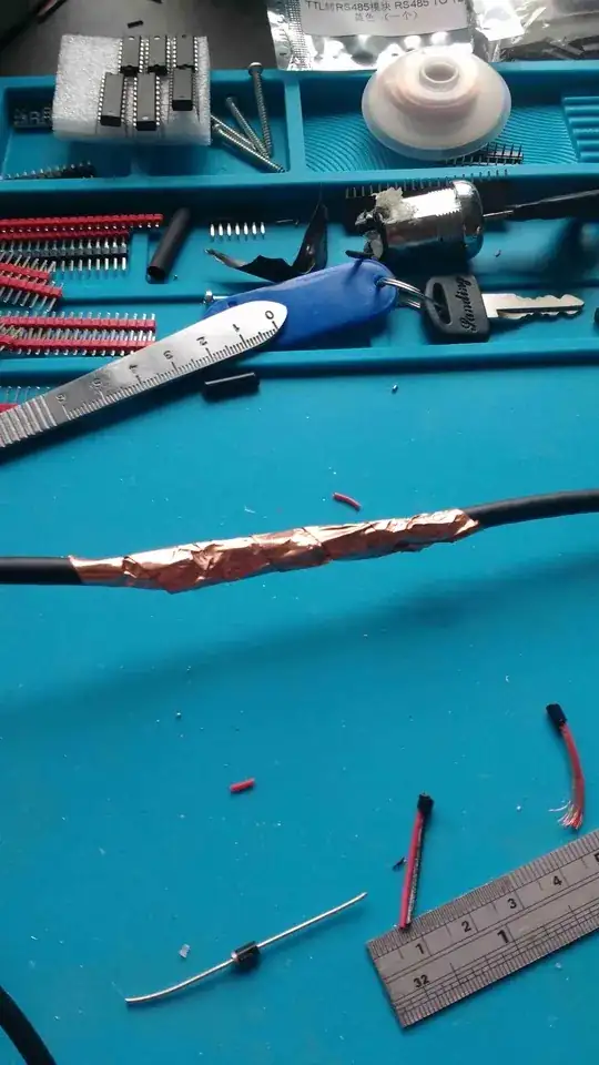

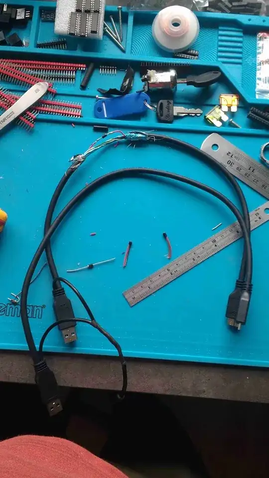

I ended up solving this by soldering in diodes in the usb cable. I wanted to run a dual HDD USB RAID NAS but the boot failure (back powering issue) got me flummuxed for a bit. Didn't want to use try usb hub (party for speed reasons - hdd would be connected through two usb hub chips inc onboard one). I used the split power cables from ebay - feeding the non-USB3 plugs with 5v from separate 3A supply and soldering in diodes in the 5v line in the cable. Be sure to make good the sheilding after. Now works great. enter image description here enter image description here enter image description here
