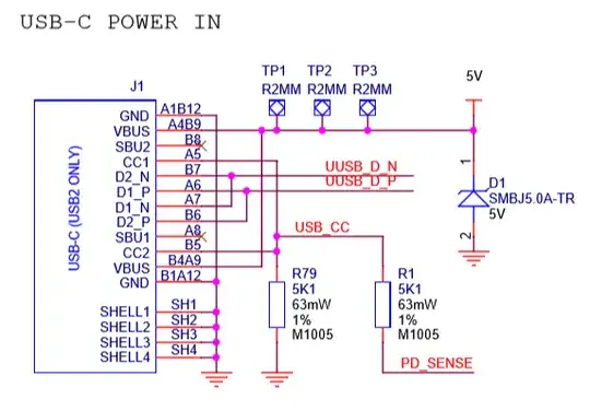

Here the schematics of the USB-C power input of the Pi 4 :
You can see that there is a resistor connected to the USB_CC lines of the USC-C socket, the other side is labelled PD_SENSE and is going into an analog input port of the MXL 7704 power management IC (AN1). This would enable the Pi to read the voltage of the CC line via the I2C bus of the power management IC.

    This does not work on the Pi 4 due to the fact that the designers only used one pull-down resistor ( https://medium.com/@leung.benson/how-to-design-a-proper-usb-c-power-sink-hint-not-the-way-raspberry-pi-4-did-it-f470d7a5910 )

    Again this does not work on the Pi 4, because of only one pull-down resistor being used.

PD_SENSE will tell the RPi it is connected to a USB-C compliant host. This could be used to detect (a) when the RPi is powered via the GPIO connector or (b) when the RPi is connected to a USB host using a legacy cable (USB-A to USB-C) as opposed to USB-C to USB-C.
Other possibilities don't seem to be logically possible:
  • Cable orientation detection is not possible with a single resistor. Nor is it necessary, as the USB2.0 signals are routed to both D1 and D2 pairs.
  • OTG dual-function port would require the CC1/CC2 pins to be toggled between GND and VBUS, yet they are permanently grounded. The overview page also states that RPi4 doesn't support host mode on USB-C.
  • Power delivery communication (reading the PSU current capacity or asking for higher voltages) would again require actively driving the CC pins.
Incidentally, USB spec requires both CC1/CC2 lines to be grounded via separate pull-down resistors, not be shorted together and pulled down by a single resistor as RPi4 does. This is a reason why chargers with active cables (notably Apple chargers) will refuse to work with an RPi4, mistaking it for an audio accessory.
