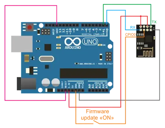

Below is how my circuit looks like

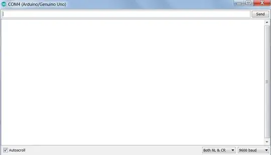

Trying to execute AT command -
On clicking on send button then it shows empty response like below -

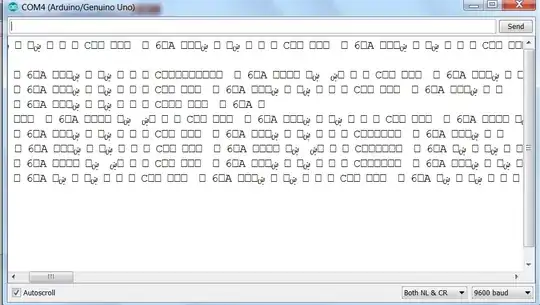

When I unplug power wire and plug it back then it prints some garbled message on serial monitor. I checked voltage on RX also, it was around 3.5V that seems also OK.

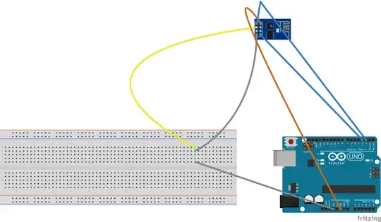

Before execute above command, I made changes in my circuit like below :-
Update
I have re-flashed ESP8266 on 115200 baud rate, and uploaded empty program then it started to respond AT commands. I connected as like above only change is TX to TX and RX to RX respectively. Alright!

Well, I want to send AT commands from the Arduino serial monitor window to ESP8266 and print ESP8266 response to the command. When I upload above program then it stops to respond, same result as like empty screen this is weird. Isn't ?

Since you've updated the ESP's firmware unsuccessfully, it's hard or impossible to know what's going on. The output in your screenshot looks rather like the result of a baud mismatch between the ESP and your terminal. You need to get a clean firmware update to the ESP before you can expect it to respond correctly and rely on its output to diagnose any other problems.

On your last picture, you should connect the Rx of your Arduino to the Tx of your ESP8266 and vice versa.
If you did that and it doesn't work, try to upload an example sketch in order to determine if it's the code or the connexions that are problematic. I recommend that you use the WiFiScan example, since that example doesn't require to change the code or to include other libraries othet than the ones from ESP8266Community.

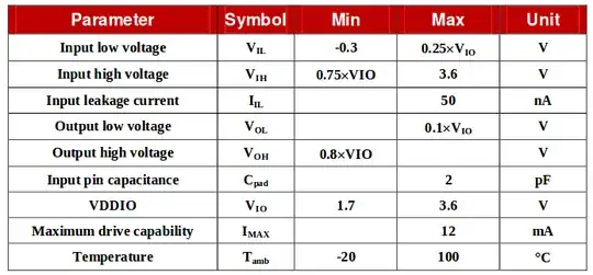

Is it possible that this is a hardware connection issue? According to the datasheet of the ESP8266, it states that the maximum voltage input is 3.6V, but by connecting directly to the Arduino, the signal output by Arduino would be more than 3.6V. (Around 5V output)
Table
Instead of connecting directly, you might want to perform Level shifting first? (5V to 3.3V, vice versa)
(Here's the link to the ESP8266 datasheet: https://nurdspace.nl/images/e/e0/ESP8266_Specifications_English.pdf)
