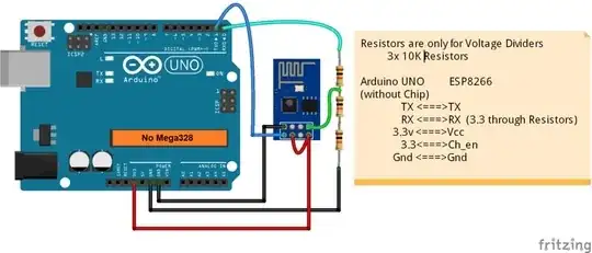

I'm using an Arduino Uno with the following scheme (I'm using pins 2 & 3 NOT 1 & 0):

I'm a bit confused by your diagram showing no ATmega chip on the Uno board, but you posted Uno code that should properly communicate with your ESP (except for the baud rate being too high for SoftwareSerial).
