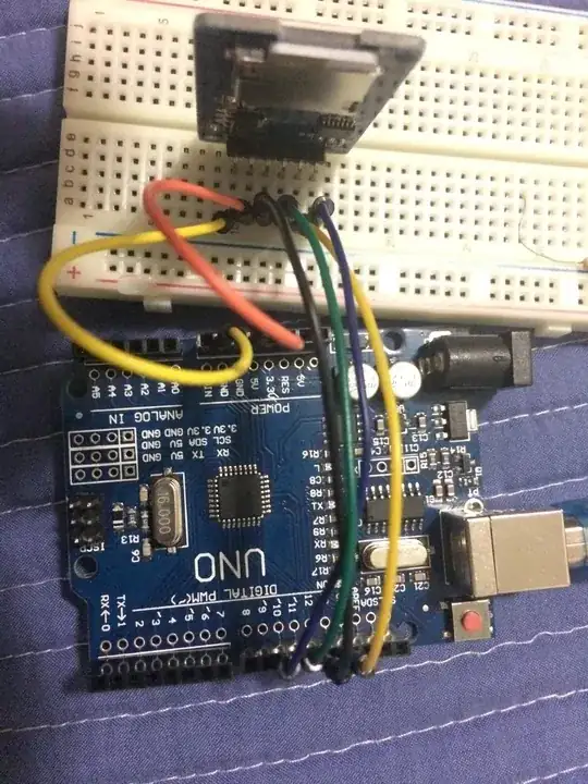

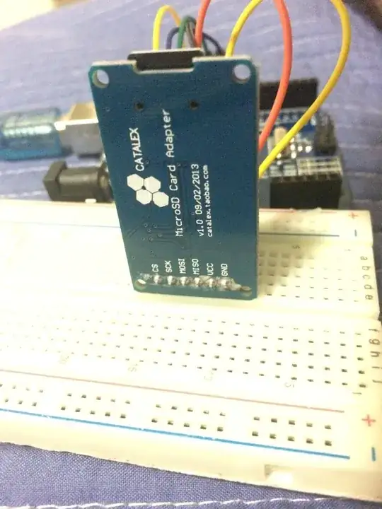

This is my setup:
Image 1
and
Image 2

SdInfo is an example, but I hope you know there's no reason to call sd.begin to re-initialize the SD library. The example is really intended to scan several different cards, not the same card.
sd.begin is normally something you would do once, in setup, even if something else is using SPI (e.g., Ethernet). You probably won't get this error in your "real" sketch.
But to answer your question:
I see that your card takes a long time to initialize (almost a full second). The error code says that the card does not re-initialize within 2 seconds. I had a similar problem, and the solution was to edit the SD library and slow down how quickly it asked the card, "Are you initialized yet?"
Error code 0x0A is SD_CARD_ERROR_ACMD41, so perhaps you can use the same technique in this loop, line 171 of SdSpiCard.cpp:
  // initialize card and send host supports SDHC if SD2
  arg = type() == SD_CARD_TYPE_SD2 ? 0X40000000 : 0;
  while (cardAcmd(ACMD41, arg) != R1_READY_STATE) {
    // check for timeout
    if (((uint16_t)millis() - t0) > SD_INIT_TIMEOUT) {
      error(SD_CARD_ERROR_ACMD41);
      goto fail;
    delay( 150 ); // <-- wait a little
