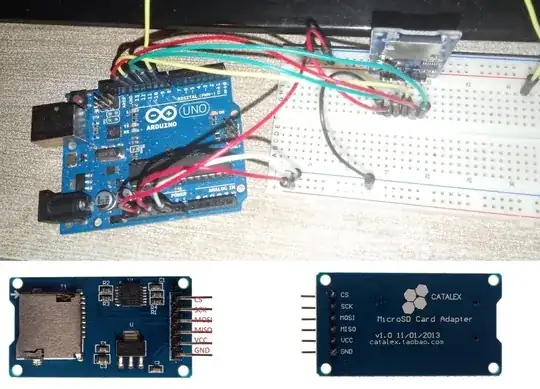

I know this question has be asked before on this site. However it was never really answered. I have an Arduino Uno. I am trying to get it to read a 2 GB SDHC Micro SD card. The problem is, the SD card never intializes. I am not sure if there is something wrong with the wiring (which I think is NOT the issue) or the SD card/shield. I have formatted the SD card, but perhaps I did use the wrong settings to do so. Additionally, this SD card is quite old, probably several years. It can still be managed on my PC however.
I bought the following Micro SD shield off Amazon. It has the pins VCC, GND, MISO, CS, MOSI, and SCK, for which I figured the following:
MISO = D0
CS = D1
MOSI = CLK
SCK = D3
I have the circuit wired in the following way:
SCK to Pin 10 on Arduino
CS to Pin 11 on Arduino
MISO to Pin 12 on Arduino
MOSI to Pin 13 on Arduino
VCC to 3.3V source on Arduino
GND to Arduino Ground
The image below is a compilation of the closeup of the shield and my wiring. Not that I am also using Pin 9 in the picture. However this is used for a different portion of the circuit.

The first thing to try is to use the 'proper' pins for the SPI:
SCK to Pin 10 on Arduino ---> Pin 13
CS to Pin 11 on Arduino ---> Pin 10
MISO to Pin 12 on Arduino ---> Pin 12
MOSI to Pin 13 on Arduino ---> Pin 11
Try that first and see how you get on.

That breakout board includes a 3.3V regulator and level shifter. It should be powered from 5V for proper operation.
Also, as @Andology mentions: use the correct SPI pins.
