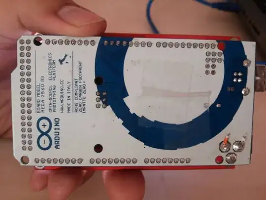

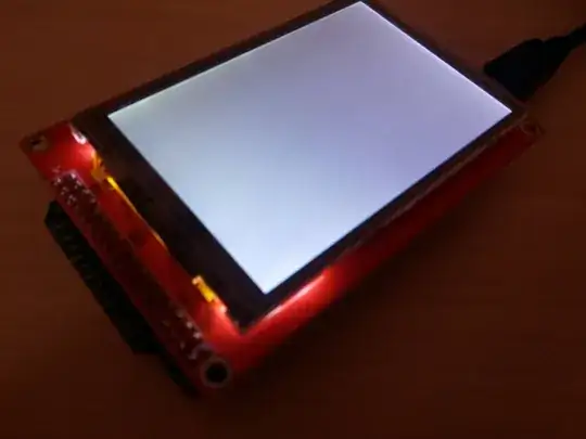

Even I can't do similarly with my 2.4" TFT LCD in here still: 2.4" TFT LCD Shield isn't working on Arduino Mega
Now, I have bought 3.5" TFT LCD display for my Arduino Mega 2560 R3 to try whether I could run the screen or not, and it is not working now! I am so depressed and angry for these two's misbehaviors. I have already checked website and a lot of Arduino IDE code examples and libraries such as UTFT.h, UTouch.h, UTFT_MEGA, UTFT_CTE, TFTLCD. I tried these and I can not run my 3.5" screen. Where am I faulty? There is something below the screen shield: www.mcufriend.com and 3.5" TFTLCD for Arduino 2560. Are there any basic code or have anyone tried to run Mcufriend's displays correctly?

I have the same lcd shield from mcufriend. It has ILI9327 in 8 bit mode.
This shield doesn't work with original UTFT library (it supports only 16-bit mode).
Try modified version from https://github.com/dgolda/UTFT and use:
myGLCD(NIC35WS,38,39,40,41); //3.5" TFTLCD for arduino 2560 from mcufriend.com
