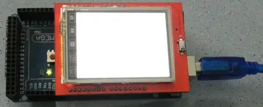

Even on ebay's website it is mentioned that I can't use 2.4" TFT LCD Shield display on attach to Arduino Mega. The problem is that I bought this shield by mistake. I want to put this shield onto Arduino Mega 2560. Is there a way to combine Mega and 2.4" Display Shield?
note: I tried on my friend's Arduino Uno. Shield is working very good.
note: The photo below is determining my question. The display not runs my Arduino's code. It only runs its LED.

I just happened to buy the same LCD Shields a few days ago, looking for a library to use it with a MEGA 2560 board I found https://github.com/Smoke-And-Wires/TFT-Shield-Example-Code which supports both UNO and MEGA boards.
Usage is very, simple if we want to use it for MEGA we should change the header #include "uno_24_shield.h" in SWTFT.cpp to #include "mega_24_shield.h"
Description (useful for adding suppport for the shield in other libraries):
Incompatibility comes from different Port mappings for Arduino pin-out between Mega and UNO.
in UNO LCD shield will be connected through:
| LCD Data Bit  |  7  |  6  |  5  |  4  |  3  |  2  |  1  |  0  |
| Digital pin # |  7  |  6  |  5  |  4  |  3  |  2  |  9  |  8  |
| Uno port/pin  | PD7 | PD6 | PD5 | PD4 | PD3 | PD2 | PB1 | PB0 |
in MEGA it will be connected through:
| MEGA port/pin | PH4 | PH3 | PE3 | PG5 | PE5 | PE4 | PH6 | PH5 |
user3473830
  • 271
A way to proceed is to create a spreadsheet showing the pin positions used by this board, and the Arduino shield signals they plug into. Next to these, you need columns showing the actual signals on the ATMega2560 (for Mega2560) and ATMega328 (for Uno) that these shield pins attach to. You can get this info from the Uno and Mega2560 schematic drawings.
In a quick look, it seems that the Arduino shield pin names for Uno and Mega are the same: for example, shield pin '0' (digital zero) is in the same location on both boards, and likewise for other pins.
However, on the Uno digital-0 attaches to ATMega328 Port D bit 0, while on the Mega2560, it attaches to ATMega2560 Port E bit 0. And things get more obtuse with digital 2..7.
Now, when twiddling bits individually using digitalWrite(pin, value), the Arduino library no doubt takes care of translating to the appropriate port/bits that need to be set for the ATMega chip and Arduino board that's in use. However, libraries that use lower-level functions (especially if they need to write entire bytes to ports, as a fast LCD library might) will need to take their own steps to make this translation.
So... first step is to determine whether there is a separate LCD driver library for Mega2560.
Next, investigate whether the library you have has initialization code that is supposed to determine what board it's running on (and is your board included?), or requires you to set some flag to tell it what board is in use.
Failing that, you could create a mess of jumpers or some other wiring scheme to jumper the Mega's ATMega2560's signals so that it's wired up like a Uno would be. It's not clear that this is possible, since some of ATMega2560's Port D is not even wired to a header.
Or you could look at the source code for the library and see what it's actually doing, and what it would need to do different to operate the ATMega 2560 pins that the shield does connect to.

Have you checked out the Library homepage? Henning Karlsen's library page
He has made a user manual for the library. There is also a reference to what pin goes where in the requirements document.

You need to compare the pins' functions between your Mega and your friend's Uno. Then you need to make those electrical connections happen. I talk about this a little in the "pin locations" section of my answer here.
This requires "hacking". Something needs to be done to reroute those physical connections. I normally use an intermediate shield to translate pins as needed. There was a shield specifically made for this purpose but I couldn't find it. Maybe this one would work?
