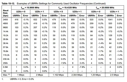

A quick glance at the ATmega328P datasheet produces the following table:

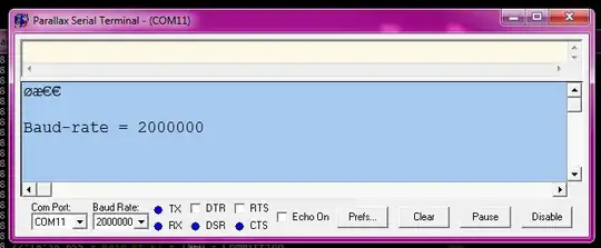

So given the max stated baud-rate of 2 Mbps, I wrote a quick test program:
void setup(){};
void loop()
delay(1000);
Serial.begin(57600);
Serial.println("\r\rBaud-rate = 57600");
delay(1000);
Serial.begin(76800);
Serial.println("\r\rBaud-rate = 76800");
delay(1000);
Serial.begin(115200);
Serial.println("\r\rBaud-rate = 115200");
delay(1000);
Serial.begin(230400);
Serial.println("\r\rBaud-rate = 230400");
delay(1000);
Serial.begin(250000);
Serial.println("\r\rBaud-rate = 250000");
delay(1000);
Serial.begin(500000);
Serial.println("\r\rBaud-rate = 500000");
delay(1000);
Serial.begin(1000000);
Serial.println("\r\rBaud-rate = 1000000");
delay(1000);
Serial.begin(2000000);
Serial.println("\r\rBaud-rate = 2000000");
And then looking at the relevant serial port with a serial terminal:
So it appears the hardware can run at 2,000,000 baud without problems.

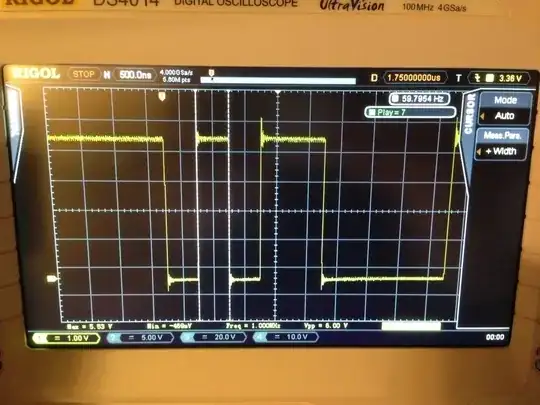

The 2 Mbps is real:
each bit-time is 500 ns, which matches exactly with what is expected.

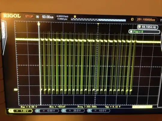

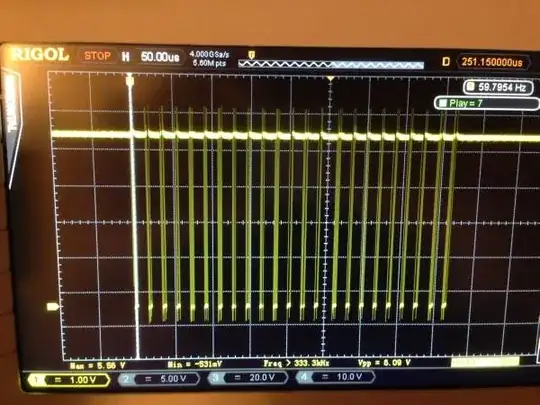

Performance issues! Overall packet length:
500 Kbaud:
1 Mbaud:
2 Mbaud:
Note: The noticeable overshoot is due to poor scope probe grounding practices, and is probably not real. I'm using the ground-clip-lead that's part of my scope probe, and the lead-inductance is likely the cause of the majority of the overshoot.
As you can see, the overall transmission length is the same for 0.5, 1 and 2 Mbaud. This is because the code that is placing the bytes in the serial buffer is poorly optimized. As such, you will never achieve anything better then an effective 500 Kbaud, unless you write your own serial libraries. The Arduino libraries are very poorly optimized, so it probably wouldn't be too hard to get a proper 2 Mbaud, at least for burst transmissions, if you spent a bit of time on it.
