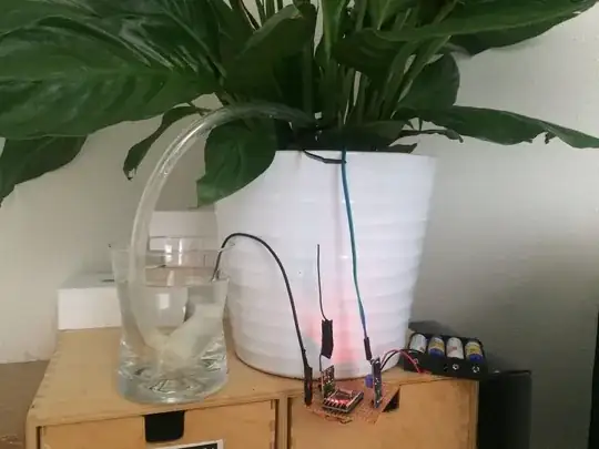

My current range is about 40/50cm, this is not much since I use a straight antenna ~17cm at the receiver and a coil antenna at the transmitter:

I have tried many antenna combinations and also upping the transmitter voltage to 12V but it doesn't help much. My aim is to reach 10m line of sight at the least.

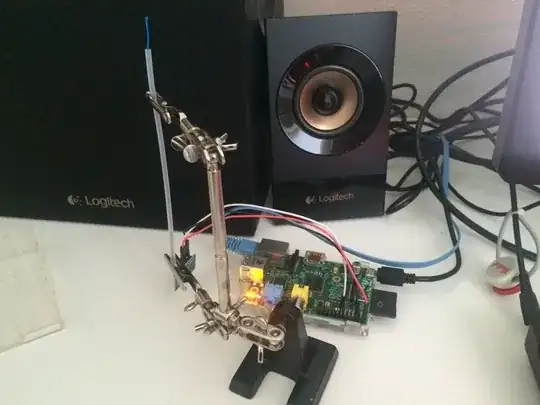

  • I notice that my Pi outputs 4.77V to the receiver.
  • The 4 penlites now output around 5V so transmitter power is low.
  • What I also like to test is adding 10uF caps to the V and GND of the transmitter but I have to wait for them to get delivered.
  • I have the 10mw version of the transmitter, they may be just useless.
  • The receiver stands in front of a speaker and a subwoofer, I turn those off when I test.
  • The 433MHz modules came in pairs. I did not respect this and use any receiver with any transmitter, wonder if this is a problem. My end-goal is 3 transmitters on one receiver.
  • Since I have multiple Tx/Rx modules, I swapped them to exclude DOA modules.
  • Also tried these Helical antenna's, only made range worse; http://www.ebay.com/itm/-/171271811976?roken=cUgayN&soutkn=TmOnpH

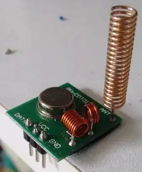

On request, picture of the antenna, soldered onto one of the cheap green transmitters, this one works well for me on 5V:
Picture of antenna
This antenna was bought as a set of 5 from: http://www.ebay.com/itm/171271811976
There's about 21 windings, with 5mm diameter, so that makes roughly 5mm * 3.14(=Pi) * 21 = 33 cm of wire in the coil.
