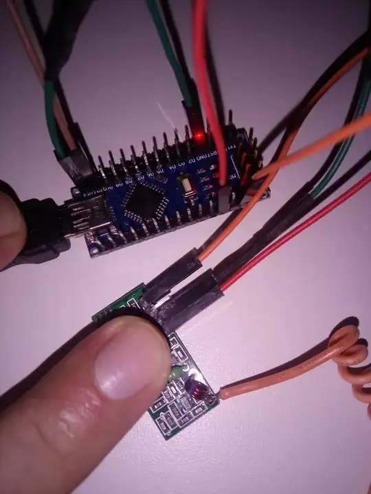

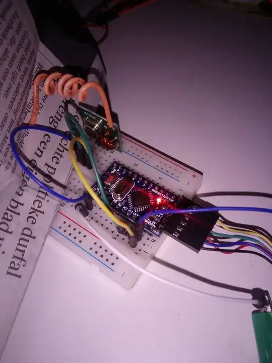

I'm trying to send data using these cheap parts. When I check the voltage on the data port of the transmitter, I see what I expect, 1.2 and 0.6 fluctuating while sending. But when I check the receiver I get 0. I've got 3 of the sets and tried them all. Also tried it with running the transmitter on 11V for some extra power. I've added a LED to the transmitter to see when it transmits and I've added a not-so-good antenna to both while they are only 5cm apart during my tests.
Any advice would be appreciated.

If you are not getting anything on the receiver, then the receiver is definitely the problem. These units will boost the gain until it get some signal, any signal.
You should be able to power the receiver + and GND (I have one, which ran on 5v, I can't see if these are the same), and put a multimeter from GND to Data, and you should get about half of Vcc, probably fluctuating a bit. If you look at the same with an oscilloscope, it should fluctuating wildly between 0 and Vcc volts. All of this should work without a transmitter, and without an Arduino (you will need a power supply for the receiver).
Note: this is from memory, I don't have mine here to test.
Once you are getting "random data" (background noise), you can progress to sending a signal.
Note that you should keep your "1"s and "0"s balanced to get a clear signal - check out Manchester encoding (this encodes a "1" as "1,0", and a 0 as "0,1", so there will be a perfect balance). You might also want to send a 1010101010 at the start - this gives the receiver a chance to adjust the gain to the correct level. Or, you can use some width-based encoding (e.g. "slow 1, slow 0" for a "1", and "fast 0, fast 1" for a "0").
AMADANON Inc.
  • 2,383
What I thought was the receiver turned out to be the transmitter. I've earned my noob medal now :) The chip with the LR433A on it is the sending unit.
The code above and the wiring is all good!
