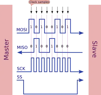

This image shows the way that data is exchanged as one byte is sent:
SPI protocol showing 4 signals
Note that three signals are outputs from the master (MOSI, SCK, SS) and one is an input (MISO).

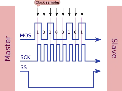

The sequence of events is:
  • SS goes low to assert it and activate the slave
  • The SCK line toggles to indicate when the data lines should be sampled
  • The data is sampled by both master and slave on the leading edge of SCK (using the default clock phase)
  • Both master and slave prepare for the next bit on the trailing edge of SCK (using the default clock phase), by changing MISO / MOSI if necessary
  • Once the transmission is over (possibly after multiple bytes have been sent) then SS goes high to de-assert it
Note that:
  • The most significant bit is sent first (by default)
  • Data is sent and received at the same instant (full duplex)
Because data is sent and received on the same clock pulse it is not possible for the slave to respond to the master immediately. SPI protocols usually expect the master to request data on one transmission, and get a response on a subsequent one.

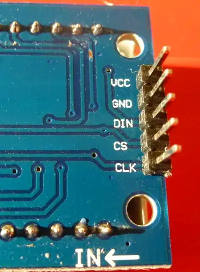

In this case you can see that the board maker has used slightly different signal names:
  • DIN (Data In) is MOSI (Master Out, Slave In)
  • CS (Chip Select) is SS (Slave Select)
  • CLK (Clock) is SCK (Serial Clock)
Most boards will follow a similar pattern. Sometimes DIN is just DI (Data In).

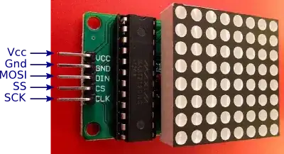

Here is another example, this time a 7-segment LED display board (also based on the MAX7219 chip):
This uses exactly the same signal names as the other board. In both of these cases you can see that the board only needs 5 wires to it, the three for SPI, plus power and ground.

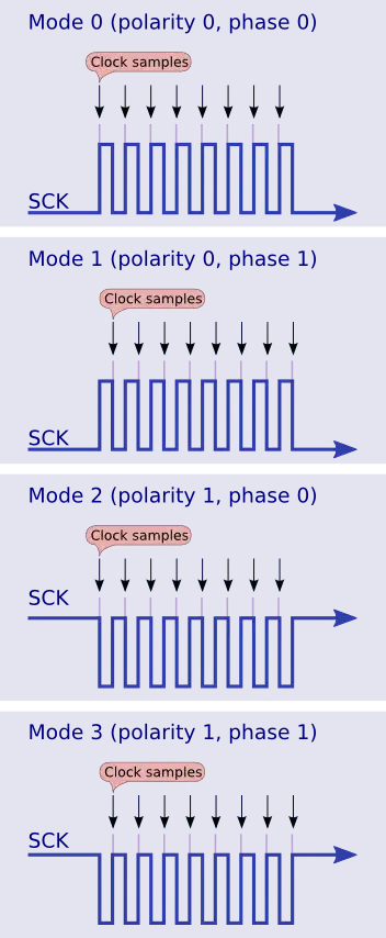

Clock phase and polarity
There are four way you can sample the SPI clock.
The SPI protocol allows for variations on the polarity of the clock pulses. CPOL is clock polarity, and CPHA is clock phase.
  • Mode 0 (the default) - clock is normally low (CPOL = 0), and the data is sampled on the transition from low to high (leading edge) (CPHA = 0)
  • Mode 1 - clock is normally low (CPOL = 0), and the data is sampled on the transition from high to low (trailing edge) (CPHA = 1)
  • Mode 2 - clock is normally high (CPOL = 1), and the data is sampled on the transition from high to low (leading edge) (CPHA = 0)
  • Mode 3 - clock is normally high (CPOL = 1), and the data is sampled on the transition from low to high (trailing edge) (CPHA = 1)
These are illustrated in this graphic:
SPI clock phase and polarity
You should refer to the datasheet for your device to get the phase and polarity correct. There will usually be a diagram which shows how to sample the clock. For example, from the datasheet for the 74HC595 chip:

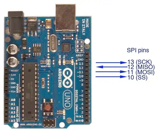

Connecting to Arduino
Arduino Uno
Connecting via digital pins 10 to 13:
Arduino Uno SPI pins

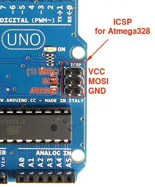

Connecting via the ICSP header:
ICSP pinouts - Uno
ICSP header

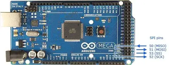

Arduino Atmega2560
Connecting via digital pins 50 to 52:
Arduino Mega2560 SPI pins
You can also use the ICSP header, similar to the Uno above.

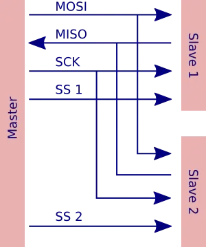

A master can communicate with multiple slaves (however only one at a time). It does this by asserting SS for one slave and de-asserting it for all the others. The slave which has SS asserted (usually this means LOW) configures its MISO pin as an output so that slave, and that slave alone, can respond to the master. The other slaves ignore any incoming clock pulses if SS is not asserted. Thus you need one additional signal for each slave, like this:
Multiple SPI slaves
In this graphic you can see that MISO, MOSI, SCK are shared between both slaves, however each slave has its own SS (slave select) signal.

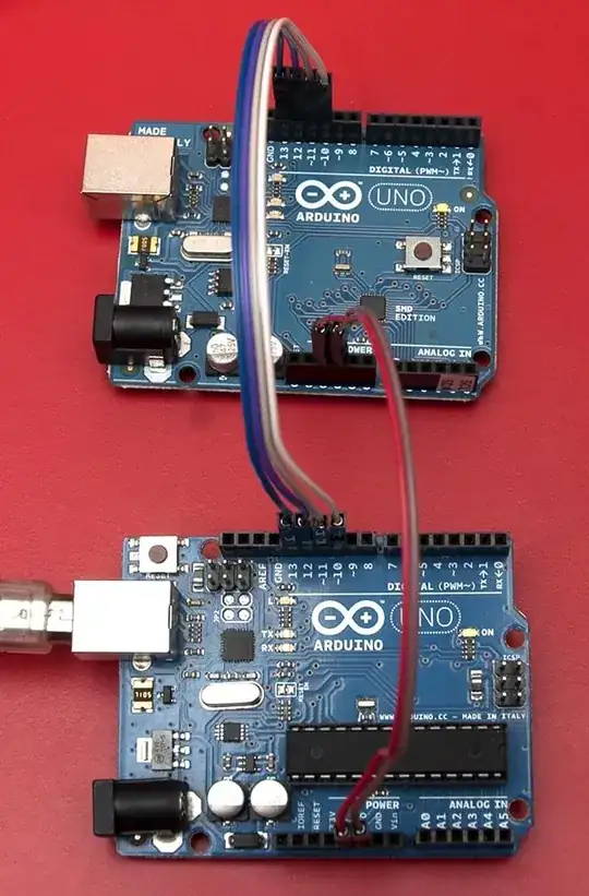

Connect two Arduino Unos together with the following pins connected to each other:
  • 10 (SS)
  • 11 (MOSI)
  • 12 (MISO)
  • 13 (SCK)
  • +5v (if required)
  • GND (for signal return)
On the Arduino Mega, the pins are 50 (MISO), 51 (MOSI), 52 (SCK), and 53 (SS).
In any case, MOSI at one end is connected to MOSI at the other, you don't swap them around (that is you do not have MOSI <-> MISO). The software configures one end of MOSI (master end) as an output, and the other end (slave end) as an input.

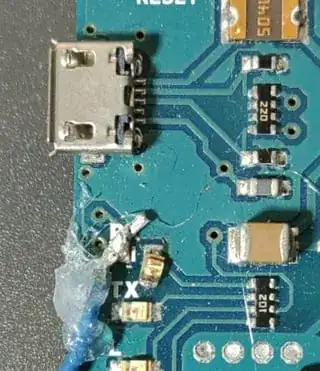

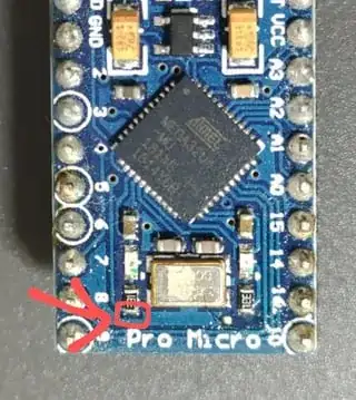

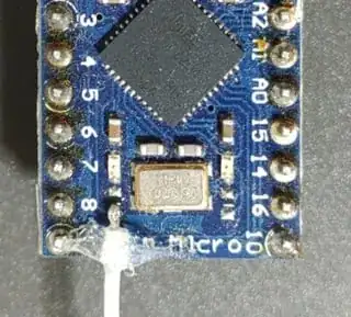

On some boards (like Leonardo, ProMicro — see above) the SS pin isn't exposed (rather it is connected to RX_LED). It is not possible to remap SS to another pin to be able to use those boards as an SPI slave as the AVR uses fixed SPI pins according to the datasheets (PB0-PB3 on 32U4).

Example of connecting master to slave using SPI
Arduino SPI master and slave

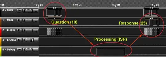

How to get a response from a slave
Following on from the code above which sends data from an SPI master to a slave, the example below shows sending data to a slave, having it do something with it, and return a response.
The master is similar to the example above. However an important point is that we need to add a slight delay (something like 20 microseconds). Otherwise the slave doesn't have a chance to react to the incoming data and do something with it.
The example shows sending a "command". In this case "a" (add something) or "s" (subtract something). This is to show that the slave is actually doing something with the data.
After asserting slave-select (SS) to initiate the transaction, the master sends the command, followed by any number of bytes, and then raises SS to terminate the transaction.
A very important point is that the slave cannot respond to an incoming byte at the same moment. The response has to be in the next byte. This is because the bits which are being sent, and the bits which are being received, are being sent simultaneously. Thus to add something to four numbers we need five transfers, like this:
transferAndWait ('a');  // add command
transferAndWait (10);
a = transferAndWait (17);
b = transferAndWait (33);
c = transferAndWait (42);
d = transferAndWait (0);
First we request action on number 10. But we don't get a response until the next transfer (the one for 17). However "a" will be set to the reply to 10. Finally we end up sending a "dummy" number 0, to get the reply for 42.

Logic analyzer output
This shows the timing between sending and receiving in the above code:
SPI master and slave timing

Mr. Nick Gammon said
However the Leonardo and ProMicro don't expose the SS pin and thus cannot be used as an SPI slave.
but I could use ProMicro and Leonardo as SPI slave devides by wiring SS signal.
Reference: https://asukiaaa.blogspot.com/2023/05/atmega32u4-as-spi-slave.html
