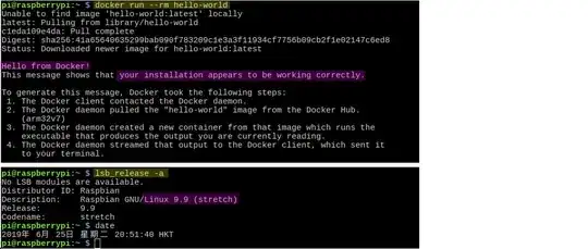

Now I am doing the first step of setting up - Installing the docker. This setup step is summarized in Appendix H below.
Update 2019jun25hkt2104
Docker Hello World running OK, though I don't know what is going on. Need to google again before moving on.

Reboot the Pi and test Docker.
$ sudo reboot
After reboot, ensure Docker is installed correctly by running a Hello World Docker container.
  • run the Docker Hello World container and remove the container
  • when finished (the --rm flag)
