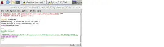

  1. After booting, you can use the following python statements to sync Network Time, then update PCF8523.
python to update time

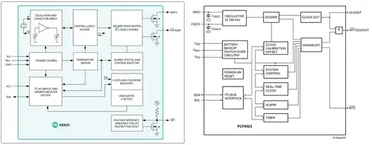

I googled comparisons of DS3231 with PCF8523 and my quick conclusion is that they are both good for hobbyists projects. DS3231 modules has the advantage that there is a temperature sensor built into the chip and an EEPROM built into the module. So I would prefer DS3231.
ds3231 vs pcf8523
