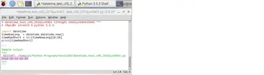

Run [bash/python] automatically at startup, timestamp is wrong, ...
Or you can try the python datetime thing.
python datetime
