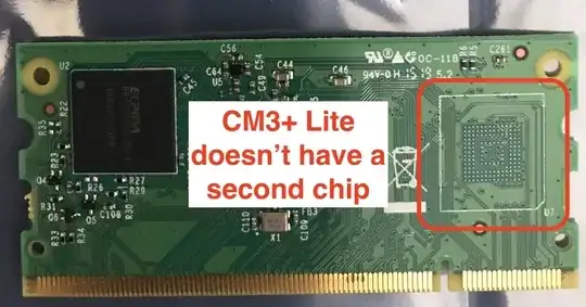

First, as there's (2) compute Modules in the kit, let's identify the CM 3+ Lite (the one with no eMMC on-board storage) so there's no confusion:
CM3+ Lite identification

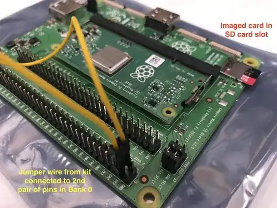

The kit ships with 4x pairs of jumper wires. We will use one of these to enable the Compute Module 3+ Lite to see the storage on the IO board that it's plugged into.
Next picture is with the Compute Module 3+ Lite inserted into the Compute Module IO board with an imaged SD card in the IO board's SD slot. Connecting the jumper wire to the 2nd pair of pins in GPIO Bank 0 enable the Compute Module 3 Lite to boot from the SD card on the IO board when micro USB power lead is connected to the "Power In" micro USB socket:
GPIO pins to enable SD card visibility connected to jumper wires
I achieved a correct result from the above procedure, but if there's any observed imperfections please advise and I'll update it.
