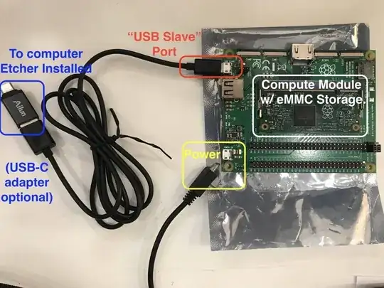

Insert a the MicroUSB end of the cable into the port labelled "USB Slave"and the other end into your computer's USB port. Picture below shows USB-C adapter attached for users with only USB-C ports (new Macbooks).
NOTE: If NOT connecting to IO board with a USB-C lead (which supplies power to it) as pictured in example, connect power lead to board before proceeding.
Connections

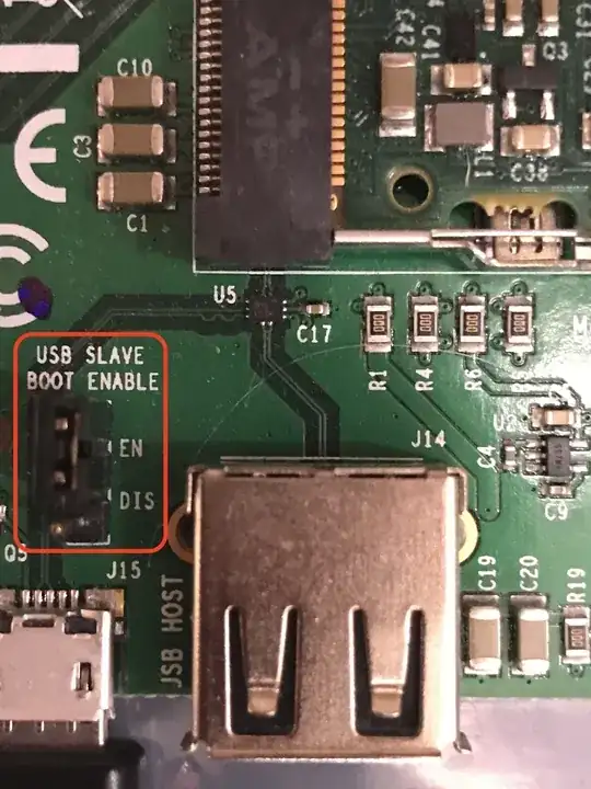

My Compute Module IO Board (v3.0) shipped with the jumper correctly set, but ensure your "USB Slave Boot Enable" is set to "EN" and looks as below:
Enable USB Slave Boot Jumper

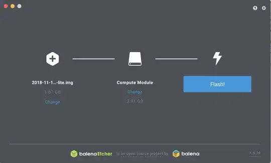

Step 3: Flash eMMC Storage with Raspbian Image
Start Etcher and then:
Set the Source: Choose Raspbian Image to be installed on Compute Module Chose the .img file of a local Raspbian image

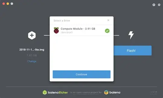

Set the Target: Choose the Compute Module which will appear as a mass storage device
Compute Module now appears as a mass storage device to select as a flashing target. Select it and choose "Continue": Compute Module shows as a Mass Storage Device
Click "Flash" Choose Compute Module
Voila. Raspbian is now installed on your Compute Module's eMMC storage. Remove the MicroUSB cable from the "USB Slave" port and the compute module can now be booted via the Compute Module IO Board by just inserting the power cable into it into the Micros USB "Power In" port.
