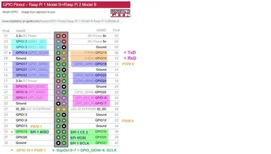

raspberry pi zero w model has no usb port. How to make zero (serial) communicate with nano?
RPF
  • 117
Rpi Zero W has no usb port. How to make serial communication?
But you can use the UART TxD (GPIO 14) and RxD (GPIO 15) pins on the 40 GPIO connector to do serial communication.

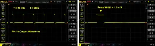

By the way, I also use Rpi PWM to control [servo] motor. I found its PWM signal rather stable. You might find more details in references below.
Raspberry Pi 3 and Zero W Serial Port Usage - 2019jan23
The Raspberry Pi 3 Model B, B+ and Raspberry Pi Zero W contain two UART controllers which can be used for serial communication, the mini UART and PL011 UART. By default, the mini UART is mapped to the TXD (GPIO 14) and RXD (GPIO 15) on the 40 pin GPIO header and the PL011 UART is used for the Bluetooth/Wireless module but either module can be mapped to the GPIO port.
rpi uart
Rpi PWM to control servo motor
rpi pwm waveform
