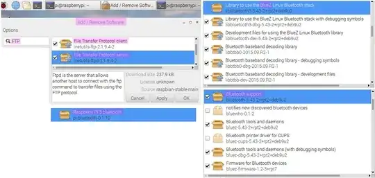

Installing BlueTooth, BlueZ, and FTP packages for Raspbian stretch 9
I first installed the bluetooh and ftp packages for testing.
installing packages
Testing Android Smart Phone Samsung Galaxy C9 Pro App to connect to Rpi3B+ using Bluetooth
I then tried the Android apps ftp server/client and send files (Bluetooth File Transfer), but found both not working. Error message is something like no ftp blue services, ...
I guess there is some incompatability problem with stretch 9 and the androd app. I need to try again later.
