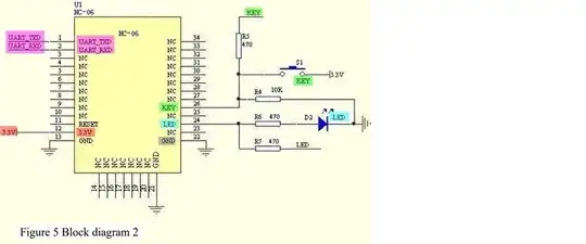

  3. The chip uses two UART pins, TxD and RxD to talk to the Rpi, using AT commands.
  4. Now let us look at the block diagram.
hc06 block diagram_2019sep1601

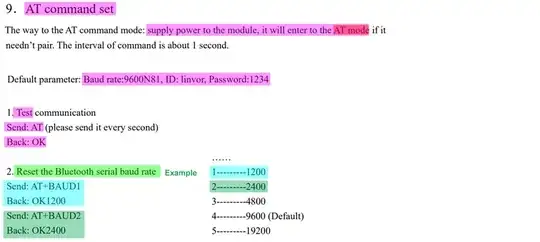

  1. Let us first make sure that the HC06 module is working, by
Sending the AT command "AT".
If the module returns "OK",
then everything is fine.
The user guide describes the AT command set in Chapter 9.
AT command
/ to continue, ...
