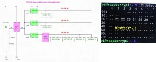

  1. I almost never use Rpi's built in SCL/SDA signals. I use TXS/TXB/02/04/08 logical level converter to level shift, but at the same time buffer/boost/isolate. Those TXS/B chips are designed to help strengthen weak I2C signals, so they are good, though not perfect, especially if you are using long wires (me over 1m), where you need I2C extenders (Google SparkFun's suggestions).

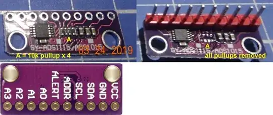

  2. Even using TXS buffers, you still have the I2C pullup overloading problem. What I usually do when first using any I2C device, is remove the device's built in pullups. This is almost an immediately cure, when I got the Error 121, remote IO error. You may like to google around to see the pictures of how other happy guys removing their I2C chips built in pull ups and problem solved.
There are more things I did but forgot now, perhaps I would update later.

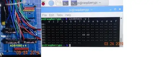

PS - Not too long ago I was trying to place 4 I2C ADS1115 ADC chips on the bus. I immediately got the 121 remote io error. The lazy hobbyist knew where was the problem, so removed one pullup, but the error did not go away. So the lazy guy removed one more, and then one more, until all pullups were removed, then everybody was happy, and the error 121 remote IO error disappeared. But the error kept coming back intermittently. The lazy guy finally found that just using one sensor is best, two is still OK, more than three then error comes up often.

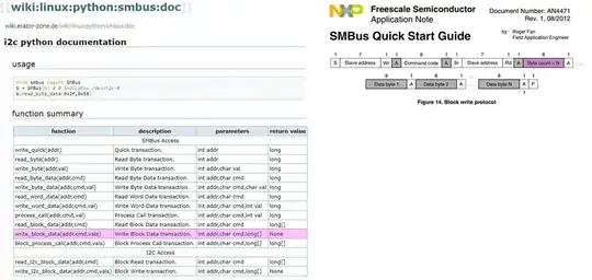

Instead of using :
bus.write_byte_data(address,0x07,0x00)
use :
i2c_write(address,0x07,0x00)
def i2c_write(add, devadrr,regdata): for attempt in range(10): try: bus.write_byte_data(add, devadrr,regdata) return True except IOError: pass return None
This way you'll intercept [121 errors] which occur erratically with I2C serial protocol. Unfortunately, there are no hardware solutions. Lenght and diameters of wires are often not the reason why it fails. Also adding time delays between data transfers doesn't change anything in most cases unlike you can read it in many forums.

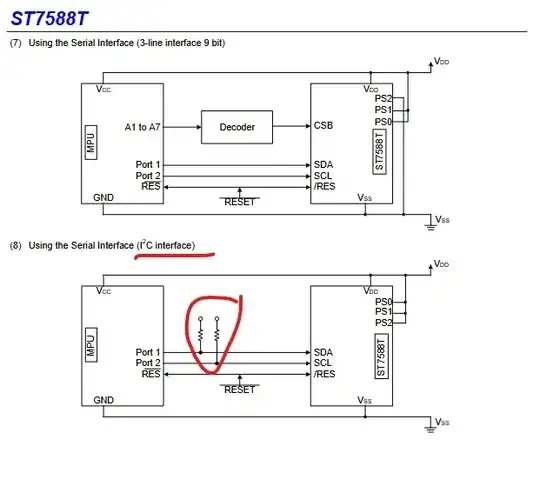

PS : some devices need pull-up for SDA and SCL. Read the data sheets carefully. If you remove it, they just can't work.
For example : enter image description here
