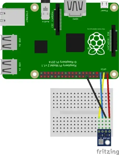

The tutorials/websites I used were these: https://learn.adafruit.com/using-the-bmp085-with-raspberry-pi/using-the-adafruit-bmp-python-library https://www.instructables.com/id/Raspberry-Pi-Weather-Station-3/
Diagram that I used as a guide to connect the BMP180: Diagram
Please note that I did not solder the pins but they are embedded in the breadboard and the wires are connected as shown in the diagram.
Am I missing something or is there a solution to this please?
