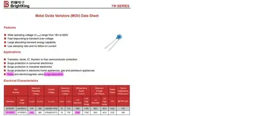

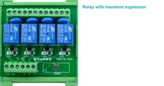

Here are two pictures of MOV (Metal Oxide Varistor, snubber) for you reference. I bought the quad relay green module with preinstalled varistors from a industrial products shop, not from eBay who sell you cheapy relays! :)
snubber
MOV
