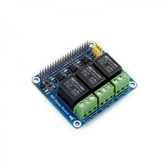

Would it be possible to use this board for the lightbulbs:
Waveshare RPi Relay Board Waveshare

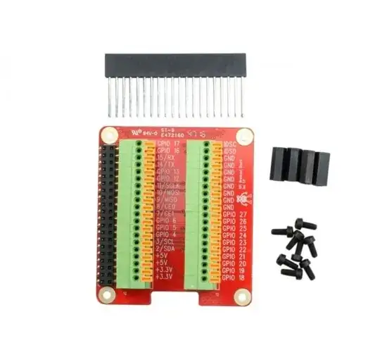

and stack another board on top of this. Something like this
Paddle Breakout HAT Board Paddle Hat
This would be compact and I could use solid core wire directly or crimp some cables with insulated cord pin end terminal ferrules which I already have.
Will this work or are there some caveats/gotchas which I have to look for? Is it possible to piggyback two GPIO boards on a single Raspberry Pi?

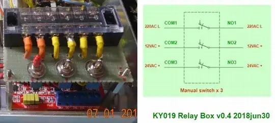

Now let me first show you my project idea.
Then the schematic.

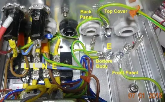

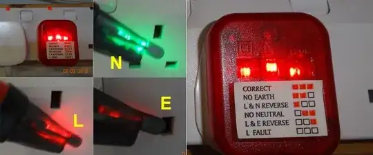

Then I got warnings that I MUST EARTH EVERYTHING (My metal box is 4 metal plates screwed together, and I was told to do earthing 4 times, one earthing to each metal piece. Oh my goodness, then I regretted to have started the project, or showing off my master piece in the forum! Anyway, I did follow the experts' advice, as shown below.

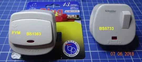

I also go severe warning on which good quality wiring, plugs, and which tools to use.

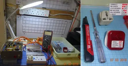

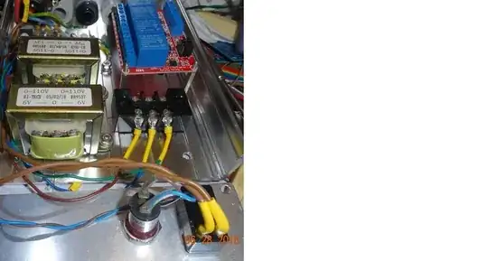

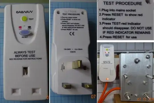

Then I started testing.
What I have not shown here is that my relay box has a 3 meter long input mains wire, and another 3 meters long switched output wires. And the Rpi GPIO 5V control signal wire going into the box is also 3 meter long.
In other words, everything mains project thing is 3 meters away from my Rpi!
