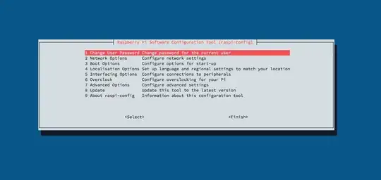

You can easily program your Raspberry Pi Zero W via SSH. Should be configured Wi-Fi connection and SSH to be enabled.
Follow the next steps:
  1. Go to Raspiconfig, just type in terminal: sudo raspi-config enter image description here
  2. choose Interfacing Options and set SSH enable. This will help to connect to Raspberry Pi via SSH.
  3. After that, go back and go to Network Options and choose Wi-Fi. Fill name and password of the Wi-Fi. SSID - name of your Wi-Fi, Password - password to it.
  4. To be sure, that all configuration work as expected - reboot your Raspberry
sudo reboot
  1. Next, need to understand the ip address of the Raspberry to connect to. For this, you should write: sudo ifconfig and you will see. In this picture ip-address is 192.168.0.104 enter image description here
  2. Connect via SSH to pi@192.168.0.104.
If you have any questions - see full description here.
