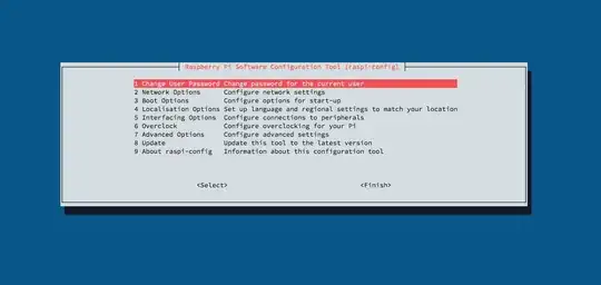

You can configure your Wi-Fi connection via raspi-config.
Follow next steps:
  1. Go to Raspiconfig, just type in terminal: $ sudo raspi-config
And configuration window will open and looks like the picture below: enter image description here 2. Go to Network Options and choose Wi-Fi.
  1. Fill name and password of the Wi-Fi. SSID - name of your Wi-Fi, Password - password to it.
  2. To be sure, that all configuration work as expected - reboot your Raspberry sudo reboot
