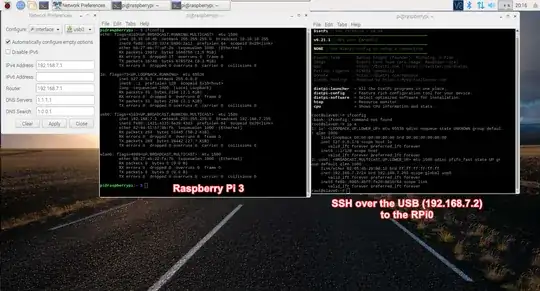

I have Raspberry Pi 3 (running Raspbian) and Raspberry Pi Zero (DietPi). The Raspberry Pi 3 is connected to ethernet. The Raspberry Pi Zero is set as Ethernet gadget (according to this https://dietpi.com/phpbb/viewtopic.php?f=9&t=1589&p=6639#p6639) and connected to the RPi3 via USB.
The Raspberry Pi 3 detects it as usb0. I've set static IP using the GUI.enter image description here
The image: ifconfig from RPi3:

How do I forward the internet from RPi3 to the RPi0? I've tried the script (edited to match my options) from: Sharing the Pi's WiFi connection through the Ethernet port
But that didn't work. ping google.com resulted in ping: google.com: Temporary failure in name resolution. I've tried adding dns to the resolv.conf on the Pi0, but also didn't work.
