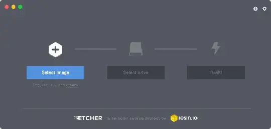

There is a tool called Etcher for Windows, Linux, and Mac. It has a simple GUI.
A screenshot from the website:
(source: etcher.io)

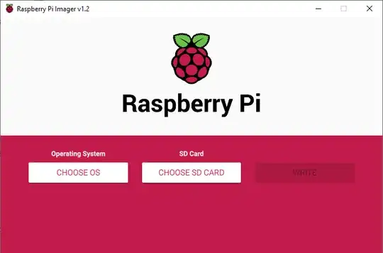

The Raspberry Pi Foundation now has their own image burning software called Raspberry Pi Imager. You can download it here: https://www.raspberrypi.org/downloads/
