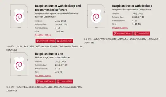

The Raspbian download page now offers separate options for "Raspbian with desktop" and "Raspbian with desktop and recommended software".
A screenshot of the download options on the Raspbian website, taken 2019-09-20
This sort of deems this question irrelevant.
