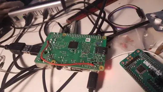

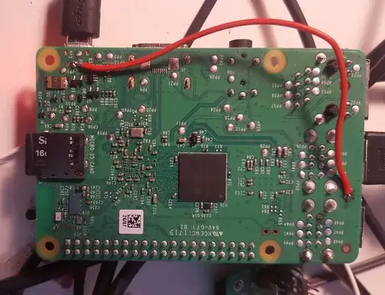

As there is no information about it on the RPi website and something definitely has blown up on the board cutting the USB 5V supply, I have decided to measure where the the "raw" USB input is and hardwire it on the board.
Here is my workaround (the wire should be shorter):
PP2/PP3 <-----> PP27
0___________
  • 240
An addition to the soldering solution:
It is PP1/PP2 <-----> PP27
PP3 is GND, so don't connect this with PP27.
See full list of test pads https://www.raspberrypi.org/forums/viewtopic.php?f=28&t=89522&p=628505&hilit=pp12%2Bpp13#p628505
Raspberry PI disables power on USB ports on reboot. With this modification there is always power on USB port and no "hardreset" of usb devices by just rebooting possible.
