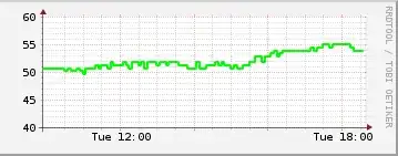

EDIT
I will try the first suggestion later tonight when I get home, but I quickly got the second one (Lenik) going which seems to be working good. I had to make some edits though to get it to work. The script wouldn't create the rrd file so I manually created it by using the syntax he used in the script. I also modified the UPDATE command since it didn't like the value that was being passed to it. I had to remove the width portion from the GRAPH command because it threw an error as well. Then at the end, I added a cp so that it places the file in the images directory of the website and then added */5 * * * * /home/root/scripts/temprec.sh >/dev/null 2>&1 to my crontab so it runs every 5 minutes. It seems to be working, but with only 4 samples so far it is difficult to know for sure. Within an hour or so I'll have a better idea if my edits have worked.
#!/bin/bash
# update .rrd database with CPU temperature
# $Id: update_cputemp 275 2013-05-16 05:20:56Z lenik $
# Thanks to Lenik @ Raspberrypi.stackexchange.com.
cd /path/to/scripts
# read the temperature and convert .59234. into .59.234. (degrees celsius)
TEMPERATURE=`cat /sys/class/thermal/thermal_zone0/temp`
TEMPERATURE=`echo -n ${TEMPERATURE:0:2}; echo -n .; echo -n ${TEMPERATURE:2}`
/usr/bin/rrdtool update cputemp.rrd N:$TEMPERATURE
/usr/bin/rrdtool graph cputemp.png DEF:temp=cputemp.rrd:cputemp:AVERAGE LINE2:temp#00FF00
cp /path/to/scripts/cputemp.png /path/to/website/images

Some time ago I wrote an article "Raspberry Pi :: Monitoring CPU temperature with RRDTOOL" about the same problem. My solution includes receiving temperature from CPU, saving it into the round-robin database and building a nice graph as .PNG file, that is quite easy to put on the web page -- just copy it wherever you want. I hope you'll find it useful.

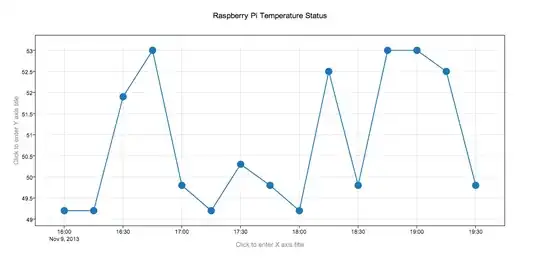

I believe you could grab and stream the data from your RPi and embed it in the browser with this package on GitHub.
Here's how a graph looks: https://plot.ly/~jensb89/12/.
Once you've generated your graph, you can embed it as an iframe with this snippet:
<iframe id="igraph" src="https://plot.ly/~abhishek.mitra.963/1/400/250/" width="400" height="250" seamless="seamless" scrolling="no"></iframe>
You'll want to swap in your URL in the code. Let me know if you have any issues or I can help with anything. Also, I'm part of Plotly, which was used in this package.
Here's how it looks:
