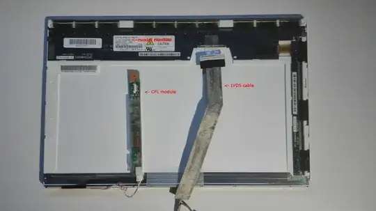

The first thing to do is to find out what is the exact model of your LCD module and what interface it has. Take out the LCD module and check out the back side: enter image description here
In my case, the LCD model is CLAA154WA05. You'll need to know the exact interface it has (most common is LVDS, but you need to know the number of channes and bits per channel) and what kind of backlight supply it needs. Google is your friend here (search for <LCD Model> + datasheet), but checking specialized sites like panelook or beyondinfinite can save you a good deal of time. Putting my model name in the search box there you can see that this panel has a 1-channel 6 bit LVDS interface and a single CCFL backlight.

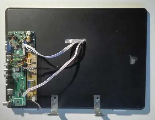

Here's how my assembly looks like: enter image description here
I salvaged the laptop's adapter to power the LCD, and added a buck converter to get 12V. I've also kept the audio speakers which I have put inside the lid case, and connected to the converter with an appropriate cable. The rest (LVDS cable, CFL module and the remote control) were bought with the LCD controller.
