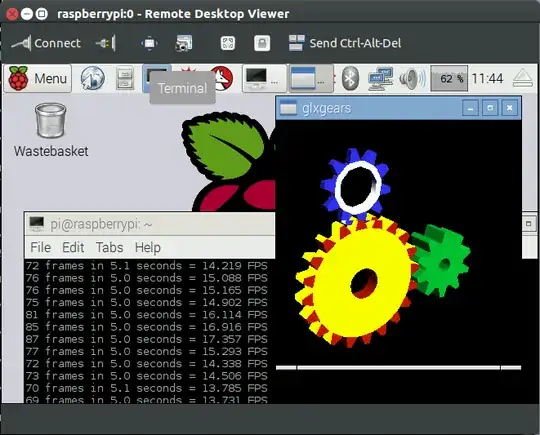

VNC step-by-step on Raspberry Pi 2 Raspbian Jessie 2016-05-27, Ubuntu 16.04 host
VNC is a server / client protocol that allows a client to access the desktop of the server.
  1. Find IP of your pi: Prepare for ssh without a screen I recommend either:
  2. SSH into the PI and run:
    sudo apt-get install x11vnc
    sudo x11vnc -xkb -noxrecord -forever -noxfixes -noxdamage \
        -display :0 -auth /var/run/lightdm/root/:0 -nopw
    WARNING: we are not setting a password for simplicity, but that is not safe. See: https://askubuntu.com/a/757398/52975 for that.
  3. In host:
    sudo apt-get install vinagre
    vinagre $RPI_IP
    Ubuntu also comes with the remmina VNC client by default, but vinagre was easier to setup
Outcome: you get a window in your desktop like:
here showing a yet buggy glxgears running (almost fixed on RPI 3 it seems: https://www.youtube.com/watch?v=WMfgXOHWAnc&feature=youtu.be&t=118 ).
You can then click on it directly with your mouse, and the state of the RPI board updates as well. If you had a display for the PI, both displays would synchronize.
