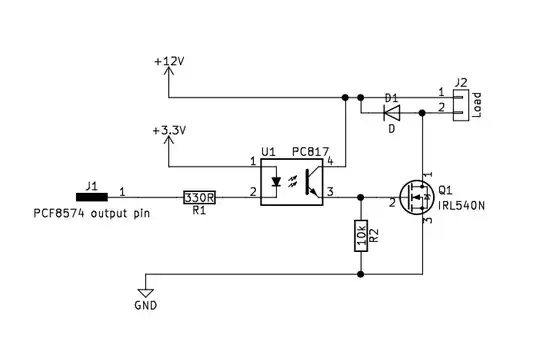

You probably don’t want to power relays and a Pi from the same source. It’s not a big no-no, just a tip. Try to keep the Pi free from anything except its own powersource, which is noisy enough.
Get 5/12V relays (auto shops carry quality 12V relays), PC817 optocouplers, 2N2222A signal transistors or 2N7000 MOSFETs, a few 4.7Kohm pulldowns if using FETs, 2N5819 schottky diodes, some PTH board, 0.5mm solid core wire.
The PC817 optocoupler IR LED switches perfectly at 3V3 with a 1Kohm resistor.
Then apply the following formula: foo
Do not have shared ground between the relay power supply, and the return ground to your Pi. Keep relay power source competely separate, the only connection should be made via the optocoupler, which can withstand a nominal 5000V_RMS.
Ensure there is a 1.5-2mm groove between NC, COM, NO relay paths by scoring the glassfiber with a boxcutter, then cover these with hot glue. The occasional spark is a fire hazard. Embed your relay board in a safe enclosure (not directly in contact with metal), use a cut piece of rubber to insulate. I use 5mm from an auto shop.
