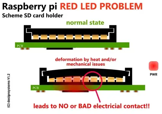

Try the pin method
sometimes the SD-card reader on the pi gets deformed over time, so applying some pressure on the SD-card with a pin or folded paper could work, also cleaning it with a brush works sometimes. refer to this for further explanation
how a deformed SD-card looks
