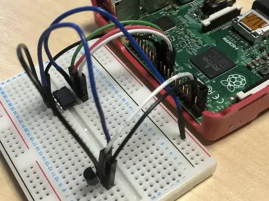

enter image description hereI am trying to connect a temperature sensor to my Raspberry Pi using this tutorial for Windows IoT Core.
I have connected all of the wires and MCP3002 correctly, but I cannot read in any values from my sensor when the app is deployed and run.
The sensor listed in the tutorial is the TMP36GZ and I have also tried a DS1822 for debugging purposes. Neither of them produce an error when connected the right way around, but the output is always 0.
I have swapped out the temp sensors for a potentiometer and that has been able to return values and print them to the screen.
All of the code is in C# and can be found on the linked tutorial.
Wiring Diagram
Update: Connected MCP3002 Pin 8 to 5V along with keeping the connection to the right leg of the TMP36GZ. Outputted values now hover between 158-164 even when held in hand etc(there is no reaction to heat). The temperature in the room is around 15-16C too. That would make sense to divide the output by 10, although I need to be able to measure an increase/decrease in heat when it is touched. I connected the potentiometer again and this produced accurate results from 0-1200 depending on the position of the knob.

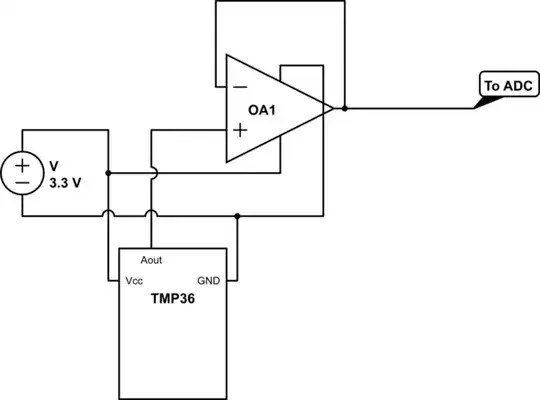

The TMP36, in my experience, will not work with Raspberry Pi this way. I do understand that there are online sources where people say it works, but that's not been my experience.
I have made it work using an op-amp as a voltage follower. I got on the right track using the instructions on this thread: https://www.raspberrypi.org/forums/viewtopic.php?p=276458#p276458
The relevant part:
The ADC chip uses an internal capacitor to sample and hold the input voltage. As the ADC performs a conversion it connects an internal switch to allow the capacitor to charge up from the input source. The capacitor needs current to charge up and this is where the issue occurs. A check of the TMP036 data sheet shows it can only output a maximum of 50uA which is a pretty small current. Indeed it's so small that the TMP036 is overloaded by the current demand when the ADC connects the capacitor and this causes the TMP036 output voltage to drop giving the under-reading. It may also be that the sample period is too small to allow the capacitor to fully charge with the limited current.
If you configure an op-amp at unity gain, it will provide a high-impedance source when the measurement is taken.
schematic
