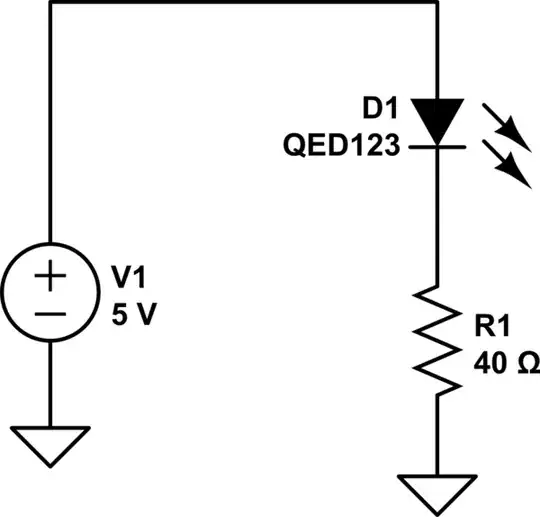

Ohm's law expresses the relationship among resistance (R), current (I) and voltage (V): V = I * R. So if we had a 5V supply and a 100 ohm resistor across it, the current I would be V/R = 5V/100ohm = 0.05A = 50mA. In your particular example, however, there is an IR diode as well. The circuit you describe with the IR diode and no transistor looks like this:
schematic
simulate this circuit – Schematic created using CircuitLab Note that I've shown your four 10 ohm resistors as a single 40 ohm resistor for clarity. In this circuit, the forward voltage is around 1.6V (which is under the the maximum VF of 1.7V per the datasheet) and the current is around 85mA. If you're using a different IR diode, you'll have to find and look up its datasheet to get the specifics for your part.

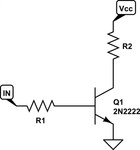

Using a transistor as a switch
What we often want from a transistor, as in your case, is for it to act like a switch. We want it "on" if the input voltage is high and "off" if the input voltage is low. There's a linear region in which transistors act, well, linearly as the current amplifier described above. That's useful if you're using a transistor as an analog signal amplifier. However, if we're looking for a binary on/off operation, we are not interested in the linear range. In fact, we seek to avoid it and operate the transistor solely in one of two regions: cut-off and saturation. The typical arrangement for driving this from a GPIO port (for any processor) looks like this:
schematic
Load resistor calculation
The resistor R2 represents the load. In your case the load is the IR diode, and whatever current limiting resistor might be needed. We can calculate that first.
The voltage and current for the IR diode, as mentioned above, we can get from the datasheet. The datasheet says that the maximum continuous current is 100mA (your datasheet may specify some other number). So we can start with that. We could either use a 3.3V Vcc or a 5V Vcc. Let's say 5V. The voltage across the diode will be less than 1.7V according to the datasheet, so 5V - 1.7V = 3.3V.
Next we look at the datasheet for a 2N2222 transistor and look up the at the VCE(sat) which means the voltage from the collector to the emitter when the transistor is in saturation (fully on). That is 0.3V at IC=150mA according to the datasheet which is close enough to our target of 100mA to use. So 3.3V - 0.3V = 3.0V. So now 3.0V/100mA = 30 ohms. You could use three of your 10 ohm resistors or a single 33 ohm resistor (which is the nearest standard value). However, I'd recommend increasing that a bit so that the IR diode isn't operating at its absolute limit. We can step up to the next standard value which is 39 ohms.
Input resistor calculation
Given that we have determined the collector current (around 100mA), we can calculate a minimum base current by using the transistor's hFE, if that's the only figure we have. So 100mA / 100 = 1mA. However, the value of hFE isn't really that useful when trying to drive the transistor into saturation. That's because hFE is only meaningful in the linear range of the device in which more base current translates into proportionally more collector current. Because we want to drive the transistor into saturation, which is a region in which more base current does NOT result in more collector current (because it's saturated), we have to add in a factor to make sure it's driven all the way to saturation. We can arbitrarily choose a value of 5 to 10 or so for that. So a 10x multiplier would give us 10mA in. The GPIO of the Pi is capable of delivering that, but let's do the calculation a different way instead.
The VBE(sat) is the base to emitter voltage when the transistor is in saturation. The data sheet gives a minimum value of 0.6V (which is very typical) and a maximum value of 1.5V at 15mA base current. If the Pi is supplying 3.3V when the pin is driven high, then the voltage across the input resistor is 3.3V - 0.6V = 2.7V. 2.7V / 15mA = 180 ohms which just happens to also be a standard value. The resulting circuit looks like this:
schematic
A few important static (DC) simulation results for this circuit are:
V(R1.nA)  = 739.5 mV
I(R1.nA) = -14.23 mA
I(R2.nA) = 83.48 mA
V(D1.nA)-V(D1.nK) = 1.656 V
We see that the input current is about 15mA, as calculated and the diode current is 83.48 mA (comfortably less than the maximum 100mA). The diode voltage drop is 1.656 V which is close to but less than the maximum 1.7V. For some additional safety margin, you could further increase the value of current-limiting resistor R2.
Note too, that this is close to the maximum specified current for the Pi, so you will have to program the particular port for that much current (current is specified from 2mA to 16mA).
