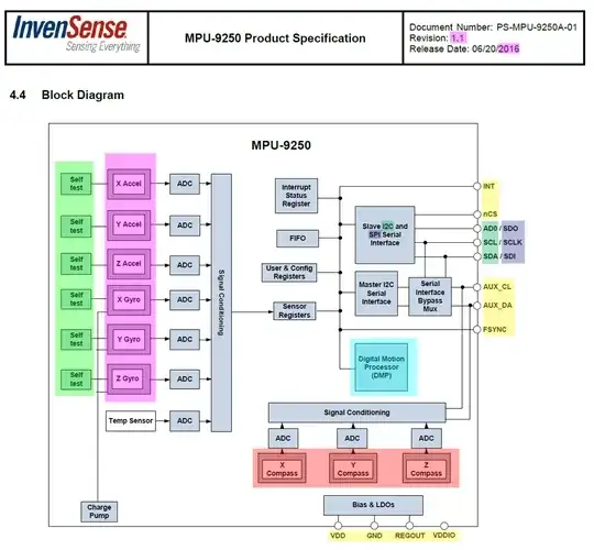

Now I am reading the datasheet, and making summaries. I usually read the block diagram to get a rough picture of the things inside the chip. (I found SparkFun's datasheet is 2 years out of date)
mpu9250 block diagram
I found SparkFun's MPU9250 Register Map is also 2 years out of date. So I have updated the above links.

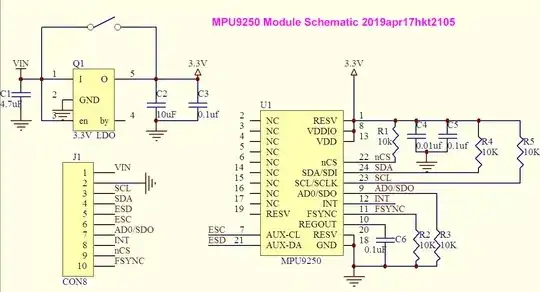

Anyway, I googled and found a schematic.
MPU-9250 9-DOF IMU Module - Thaou Electronics
mpu9250 schematic
