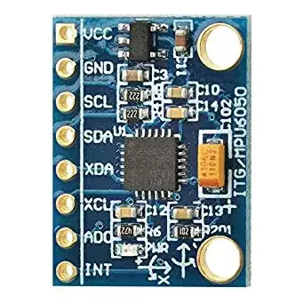

The MPU-6050 is a great choice.
To use it on Raspberry Pi 3, you need a python module. Follow instructions:
1. install the python-smbus package
sudo apt install python3-smbus
2. Install this package from PyPi repository
pip install mpu6050-raspberrypi
If you find a problem, post an issue here.
