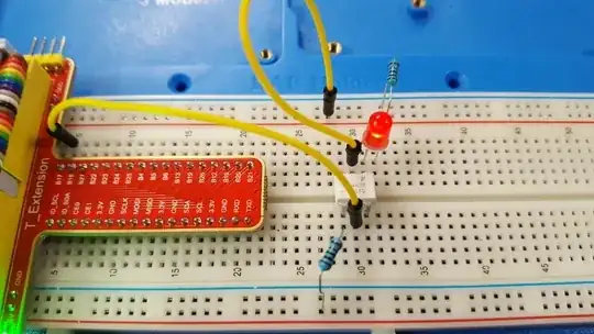

I am learning how optocoupler works. Now I am passing Lesson 8 4N35
I've found why resistor needed for LEDs, but why there is need for resistor between optocoupler and power supply/input pin?
Board with optocoupler 4N35 and led

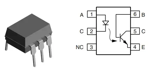

Inside the optocoupler is an IR LED on one side (between pins 1 and 2) in the image below and a phototransistor on the other (pins 4, 5 and 6).
optocupler
And so the resistor is there for exactly the same reason it is in every other LED circuit to limit the current and thereby protect the LED, as this quote from the tutorial you are following makes clear:
To protect the LED from burning, usually a resistor (about 1K) is connected to pin 1.
