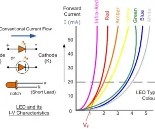

The Current and Voltage Relationship in a LED:
To understand why it is necessary to limit the current through an LED, we will need to understand this:
Once the LED is forward-biased, small increases in the voltage cause exponentially greater current flow. If the current is not controlled, the LED will eventually be destroyed.
This non-linear relationship between voltage and current in a diode was described in 1949 by William Shockley with an equation that now carries his name - the Shockley diode equation.
LEDs generally follow Shockley's equation, but as the figure below shows, the parameters (e.g. Is) of the equation vary depending upon the band-gap of the semiconductor material used - which determines the color of the emitted light. The prominent feature of these V-I curves is the slope of the curve as the input voltage to the LED increases.
Conclusion: LED Current Must Be Limited to Avoid Device Destruction
