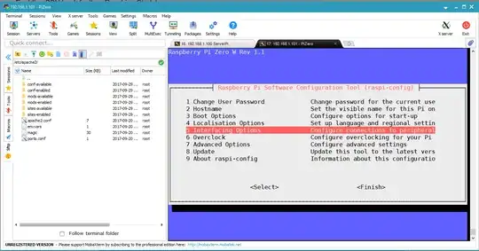

or setting from
sudo raspi-config
then -> interfacing options -> enable ssh
EDIT enter image description here
