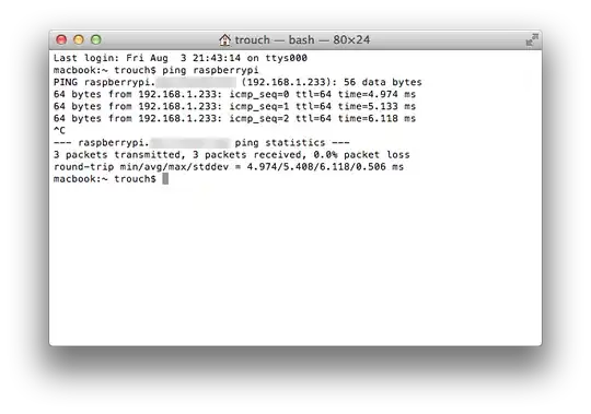

In Windows Command line, or any OS that has ping command you can type in:
ping raspberrypi
It will resolve the DNS entry and show you the IP address. In the image as 192.168.1.233
But of course, you might just connect using the host name raspberrypi instead of IP.
This all assumes that you are using a router with DHCP and DNS running on it. Most internet ISP will provide you with a router that does this out of the box. But if you got custom DHCP or DNS, then you should really know how to find/set the IP yourself.
