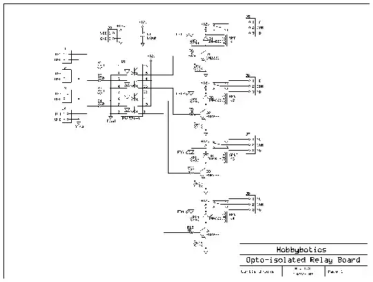

Referring to below schematic, you would connect DGnd to Raspberry Pi Ground, IN1 to Raspberry Pi GPIO, Supply Relay voltage (12V in this case) at J9 and connect your load (bulb) at J5 (in series with your load supply voltage, same as your current module).
Reference Schematic
Although you can use other transistor based solutions but an opto-isolated board with keep your Raspberry Pi safe as the power rails will be kept isolated.
