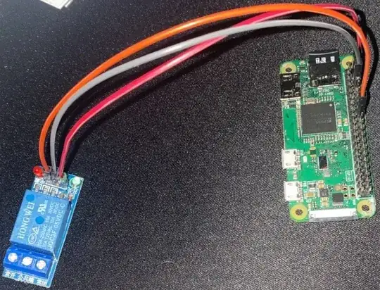

so this is my first time trying to use a Raspberry pi and I wanted to automate a motor using a 5v relay module. I'm using a Raspberry Pi Zero W. I am using a 5v 2amp power supply to power the Raspberry pi.
The relay's VCC pin is connected to the pi's physical pin 2 (5v power). The relay's IN pin is connected to physical pin 16 (GPIO 23). The relay's GND pin is connected to a ground pin on the pi. When I power up the pi, both the red and green LEDs turn on on the relay and I hear a click from the relay. If I disconnect the IN pin, the green LED turns off and I hear another click.

Picture: (on the relay module, from left to right, the pins are: IN - GND - VCC)

These modules are unsuitable for the Pi without modification. See Can you use a 5V Relay Module with the Pi?
Also if you connect to 5V you risk damaging the Pi.
I had the same issue with raspberry pi4. Connected to the 3.3v which is the pin 1 and it worked.
