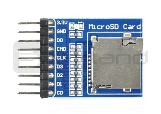

I found a MicroSD card reader module working with SPI. Is it possible to connect it to Raspberry Pi Zero W via GPIO?
Module scheme
EDIT: The module can also be connected via SDIO pins. Which of these two methods (SPI or SDIO) would get the most performance for card reader?
SD Card Reader

Here is SDIO pinout at Raspberry Pi end:
To answer you question about performance, SDIO will get you better performance over SPI.
Reference: https://pinout.xyz/pinout/sdio

You can enable your SPI configuration through #sudo raspi-config and then wire it with your Pi Zero W. You can look up more via this post, is this what you're looking for ?
How can I wire this SD card reader to RaspberryPi?
