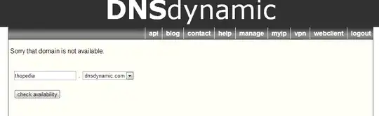

2.Setting up a dynamic DNS
Most probably the IP address assigned by your ISP is dynamic and so we need a way to resolve the changes in IP address.I use dnsdynamic and ddclient software to achieve this.Both are free to use.
a.Sign up for a account with dnsdynamic
b.Add a new domain and select a name and the domain from the list.You can choose any of the available domains with your choice of subdomain.Click on check availabilty and then add
dnsdynamic screenshot
