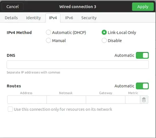

In my case Ubuntu 19.04 I didn't get IP address from Raspberrypi Zero
You can fix it easy just change "USB Ethernet" settings
**IPv4 Method** Automatic (DHCP) --> Link-Local Only
After that you will get a 169.254.xxx.xxx IP address.
ping raspberrypi.local ssh pi@raspberrypi.local
