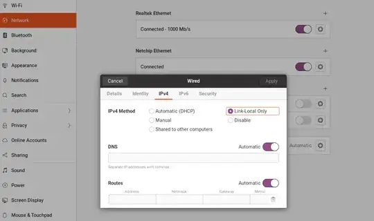

I have experienced the same issue using Ubuntu 20.04 as the host pc.
I managed to get a connection to my raspberry pi by changing the network manager's IPv4 Method to Link-Local Only in Network Manager.
This then allowed the connection to complete and I could then ssh into the raspberry pi using the raspberrypi.local address.
The Link-Local setting in Network Manager
I'm still working on getting network sharing working so that the raspberry pi can then use the host's internet connection.

In Linux Mint 20.1, the Zero shows up as Netchip Technology Linux-USB Ethernet/RNDIS Gadget if you hover the networking icon. If you click on Wired Connections, the Zero most likely shows up as Wired Connection 2 since the Ethernet card in the PC is Wired Connection 1.
Do as gilesp wrote above about setting the IPv4 Settings --> Method to Link-Local.
